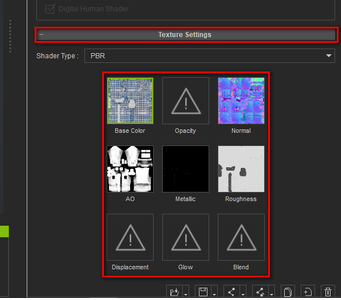

Texture & Material Settings

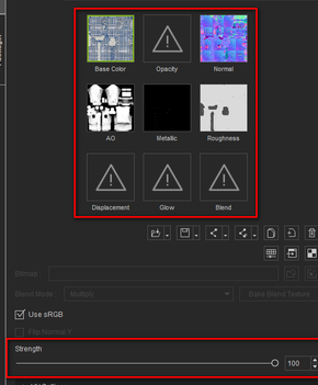

Shader Type
  • Must be set to PBR
Required Texture Maps
  • Base Color
  • Normal
  • Ambient Occlusion (AO)
  • Metallic
  • Roughness
Optional Texture Maps
  • Glow (emissive effects)
  • Opacity (lace, ripped fabric, transparency)

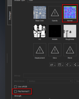

Normal Map Settings
  • Flip Normal Y must be unchecked by default

Texture Strength
  • All texture channels must remain at default value: 100

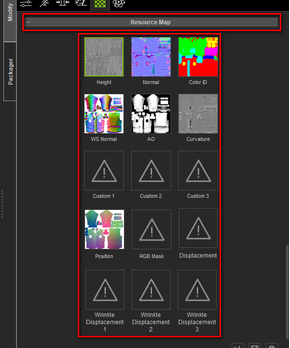

Resource Map Configuration
Standard clothing assets only require the Texture Settings above. Resource Maps are only needed for advanced workflows.
FashionGen (2025) Workflow
  • Color ID map is mandatory
  • Curvature map is recommended (optional)
  • Automatically detected from Resource Map slots
Legacy Material Support (MAT3 / MAT5 / MAT7 – Appearance Editor) If enabled, load full Mesh Data Maps:
  • Height
  • Normal
  • Color ID
  • World Space Normal (WS Normal)
  • Curvature
  • Position

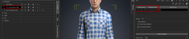

  • Naming Consistency
    • Mesh Name must match Material Name exactly
