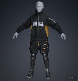

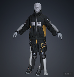

Before and After Refitting
The following examples compare the garment before and after fitting it to the character.
Before Refitting After Refitting
