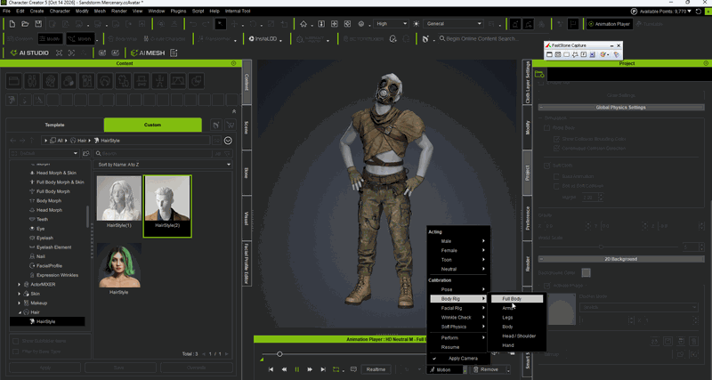

Inspecting Full-Body Deformation
The Full Body motion is suitable for comprehensive motion testing of full outfits, one-piece garments, and multi-piece sets.
Select Motion > (Calibration) Body Rig > Full Body to inspect how the clothing and accessories deform during full-body movement.

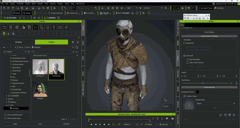

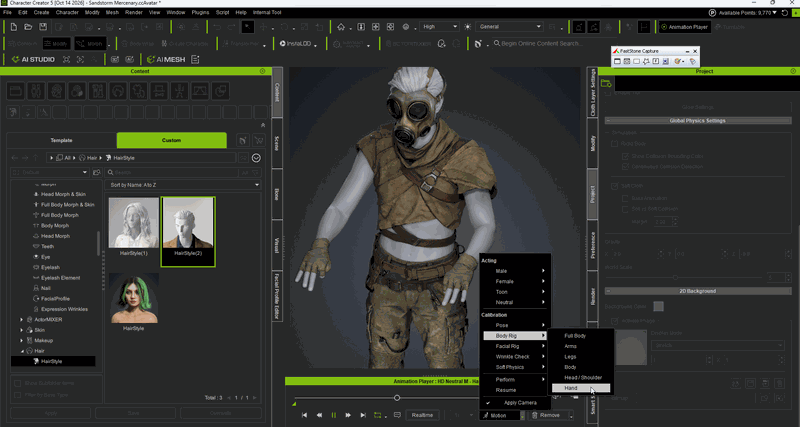

Inspecting Hands and Gloves
For gloves, hand accessories, or hand details, apply the Hand motion to inspect deformation as individual finger joints bend.
Select Motion > (Calibration) Body Rig > Hand and carefully check for mesh penetration (clipping) and stretching.
